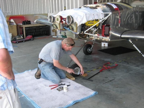

Brief Description:  Nose Wheel breakout force

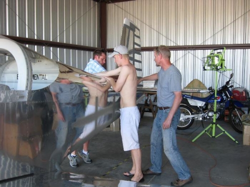

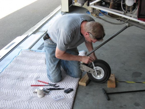

Travis, Darren and Gayle kindly volunteered to assist with the task of setting the nose wheel breakout force (and this in really hot temperatures!!). Darren and Travis pushed down on the tail to bring the nose wheel off the ground. Gayle pulled on the high-tech fish weighing scale while I set the torque on the Nose wheel fork nut to achieve the desired 22 ft lbs. of breakout.
Travis and Darren being instructed on where to push on the tail

Tightening nut after removing the scale
