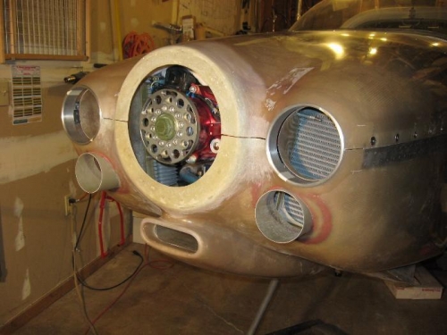

The parts cured overnight. Trimmed the inside portion of the vents so the bottom cowl could be installed with the radiator plenums in place. Marked and cut the plenums to match the vents. Next will be to glass the circular portion of the vents to the plenum.

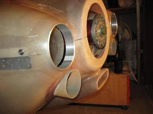

A side view of vents protruding from lower cowling. Some trimming is required.
