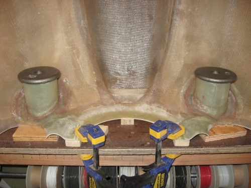

Brief Description:  Radiator cowling vents

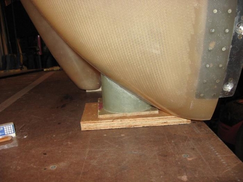

Mixed up a batch of thickened resin and filled the open edges of the honeycomb. Also, added a fillet to a 45 degree all around the vent tubes where they meet with the cowling. The vent tubes are set in such a way to have them protrude out through the hole in the cowl facing the airstream. I may decide to keep the protrusion and create a molded ring around the vent. The reason for them protruding is it will likely increase the pressure of the air on the radiator face. Will decide later if I want to keep them or not. It will probably look better without them.
Weights used to keep parts in position and stable during cure
Cowling on it's end on the bench.  A sideview of the right vent protruding forward
