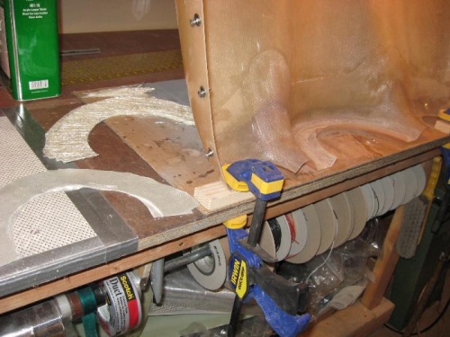

Spinner gap modification
Applied fiberglass (over a 1/4 inch thick) to the upper cowling behind the spinner ring. This took all day to prepare and do.
Upper cowling prep with cloth mat and glass (mat used for thickness - mostly will be ground away)
Applied and curing now...
