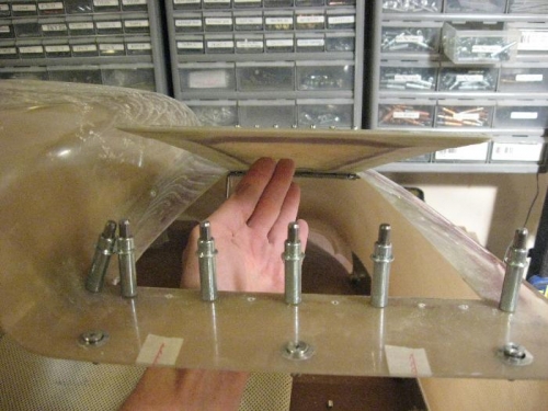

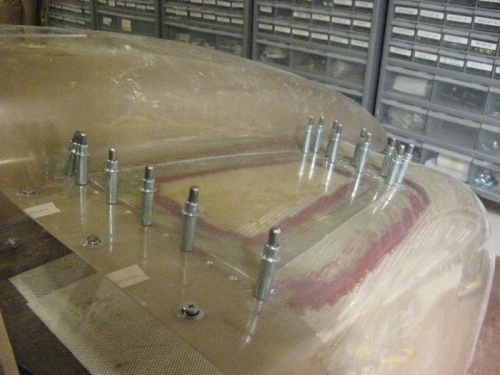

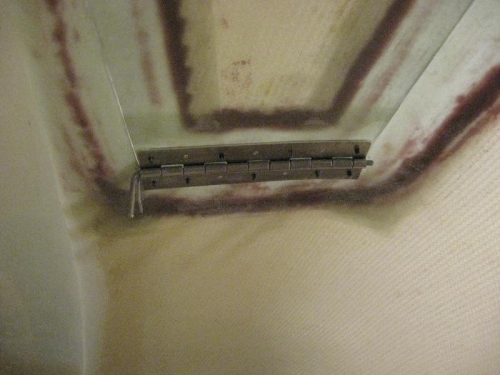

Now that the Cowl flaps have cured, it's time to rough-in some hardware. Cut the hinges and a trailing flange to provide the fore and aft structures for the cowl flaps. Did a whole lot of filing on the flaps to get them to lay down and match the smooth contour of the cowl. Working out nicely so far....
Hinge roughed-in with a tab to secure the pin (with safety wire later on)
Left side laying down nicely...
A view of the left side in the open position...
