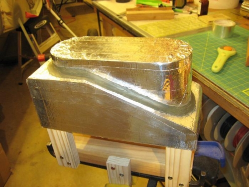

Brief Description: Fiberglass mold for radiator inlets
Not having much fun. It turns out the mold I made had a flaw which is the sharp 90 degree angles along the top edges of the box. The 4 ounce glass I was using just would not make that sharp of a bend and bubbles developed. Pretty dis-heartening. Scraping this mold and will come up with another plan.
While it looks pretty, the long horizontal edges are 90 degrees -- bad for glassing!
