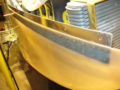

Brief Description:  Fitting the cowl
Applied ProSeal to the bottom cowling horizontal fastener attach strip area after carefully masking off all areas where I don't want the sticky stuff. Riveted the fastener attach strips. Had to work quickly due to the cure time of the ProSeal sets up within a couple of hours. It won't cure fully for days though. Even had Gayle out in the shop to hold things steady so that no time was wasted finishing up the riveting. The ProSeal started setting up so quickly, it surprised me some, even though the garage was cool. Next, using the templates provided by Skybolt, prepped the SkyLoc fastener holes on the upper firewall. Should be able to install those tomorrow.
Kinda an odd view due to how I held the camera, but this is the upper firewall attach strip
The darkened area is the ProSeal curing which is sandwiched between the fiberglass and attach strip
