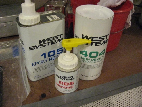

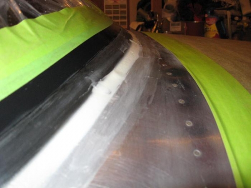

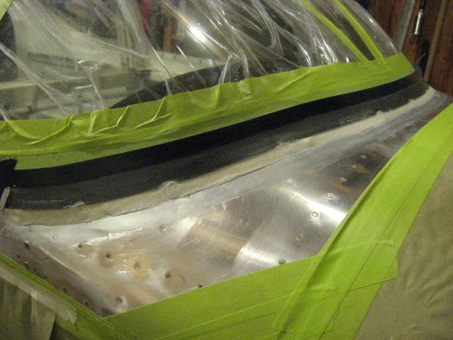

Mixed up a stiff batch of Epoxy filler using the West Systems products: 105 Epoxy Resin; 205 Hardener; and the 404 High-Density Adhesive filler. Created a fillet where the plexi meets the aluminum. Let things stand overnight.
Products used for the fillet
Fillet left to harden overnight
A closer look
