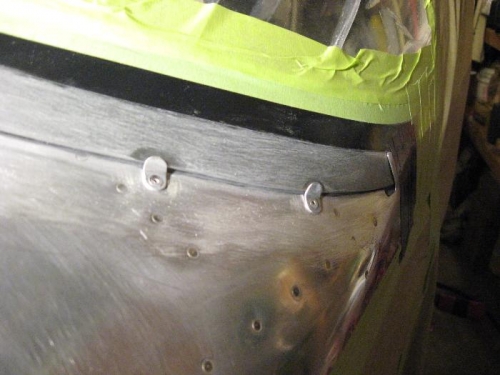

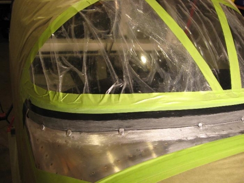

Masked off forward canopy and the fuselage. Used two layers of electrical tape to define the fiberglass line on the plexiglass. Then used 80 grit sand paper to scuff up the plexi and the aluminum. Tomorrow will be the day to start the fiberglass.
Scuffed up..
More scuffing...
A closeup of scuffing
