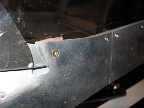

Brief Description:  Secure tab on Plexiglass trim - left side

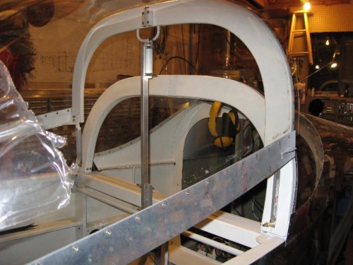

Decided to warm up the garage to the point I was uncomfortable. This to make sure that the plexiglass was also nice and warm. I was getting nervouse about finishing the left side with cold plexiglass and risking a crack. After half the day, the garage was very warm. I also used a hot air gun on the area of the plexi I was drilling. In the end, it was a non-issue -- but it's best to work with warm plexiglass. While things were warming up, I decided to fabricate some stand-offs to hold the canopy off of the rail at a height that would later make installing the screws and nuts easier.
Tabs now laying down nicely
A view of the stand-offs holding up the canopy
Another view...
Another view...
