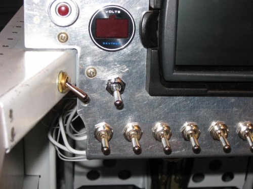

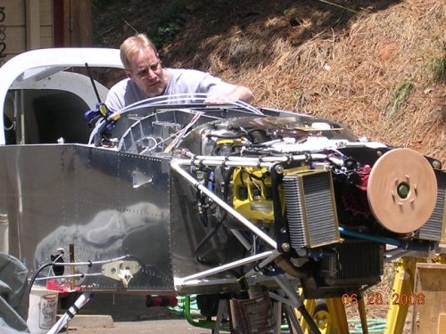

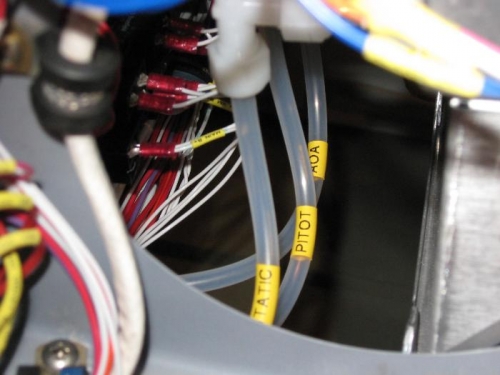

Installed all of the avionics back into the panel to check for operation. Started the E6/200 up to charge the batteries some before testing the Avionics. Issue with Garmin GNC 300/XL where it's not picking up any satelites even with the antenna connected. Need to look into that. Moved on to plumbing the Static and AOA lines to the back of the Dynons. Not the most fun job, but glad it's done. Next, I installed the Alternate Static source switch and completed the plumbing for this by tying it in and running to the back of the Dynons. Very happy with the setup.
Running the E6/200 after panel re-installation
Lines coming up from underneath
Alternate Static switch on the left - in the Off position
