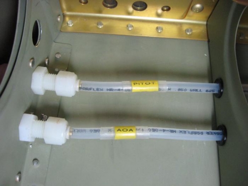

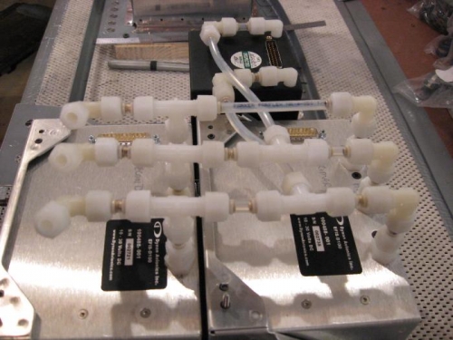

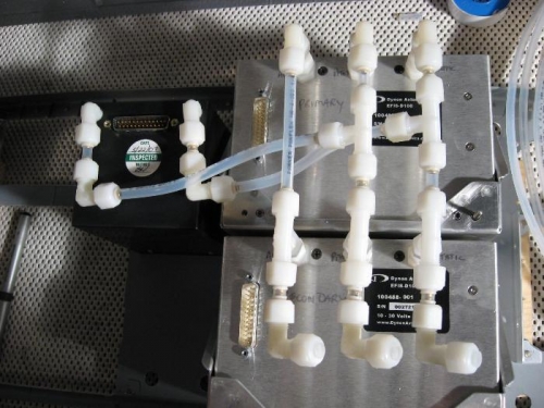

With the panel out of the fuselage, fabricated the lines that connect both Dynon's as well as the TruTrak AutoPilot. The AOA line is specific to the Dynon's; however, the Pitot and Static lines need to feed the AP also. Ran the Pitot and AOA lines down the firewall and through the center section where they take a left out to the wing root.
Connections behind the instruments
Another view
Another view
Pitot and AOA at the left wing root
