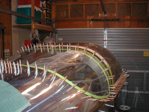

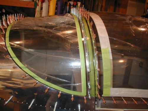

Brief Description:  Fitting the rear window
Marked and drilled all of the holes in the skin and the cabin frame. Then pretty much followed Van's directions in the manual for the sequence to drill the plexiglass. Marked the forward line on the rear window to match the canopy, then removed the window and trimmed to match.
A view from the right
The left...
The left...
and right rear
and right rear
