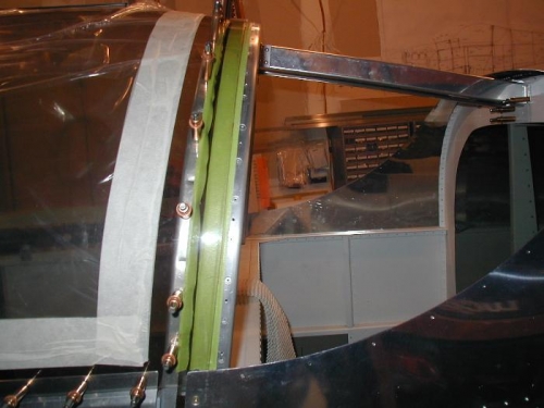

Brief Description:  Drilling the canopy to the frame
I stressed over this stage of things until I actually started drilling the holes in the canopy. It was not as bad as I thought. I chose to first drill the holes in the frame with a #40, then once the canopy was taped down tight, I used a unibit to drill through the plexiglass to just meet the #40 hole in the frame. I then deburred all of the holes in the plexiglass.
A view from the right

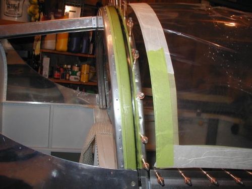

And the left...
And the left...

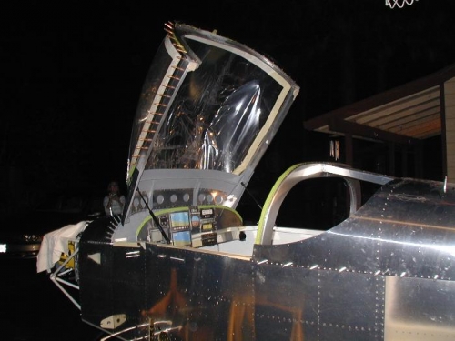

And raised
And raised
