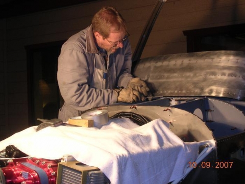

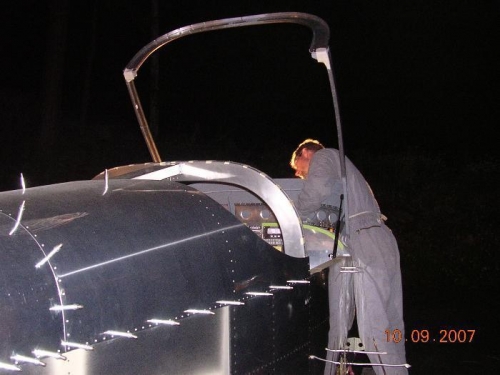

Brief Description: Trim canopy skin for proper operation
With the struts in place, there is a fair amount of forward push on the frame when it's in the closed position. This required that additional trimming be done on the canopy skin so as to not rub with the upper fuselage skin when opening.
