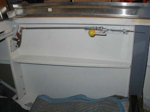

Aft Canopy latch
Marked and drilled the C-611 block for the vertical position of the bolts. Drilled the holes then enlarged them with a #10 drill bit. Installed the VS-411 brackets and links and fabricated the C-710 push rod. Tested everything for fit.
View of the left side latching mechanism
