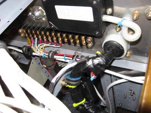

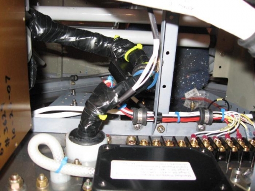

Brief Description:  Wire strip for engine wiring

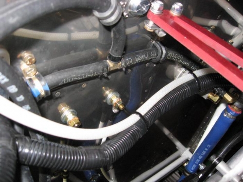

Installed the wire strip for the engine wires on the cabin side of the upper firewall. Also used two of the mounting bolts on the firewall side to secure the 5/16 water line between each side of the engine. Routed the five primary engine wires to the wire strip, then added the wire that energizes the Alternator OV contactor. Also added the two Prop Servo wires to the strip.
Wire strip on cabin side of firewall
Clamps for the 5/16 water line sharing mounting bolts with wire strip
