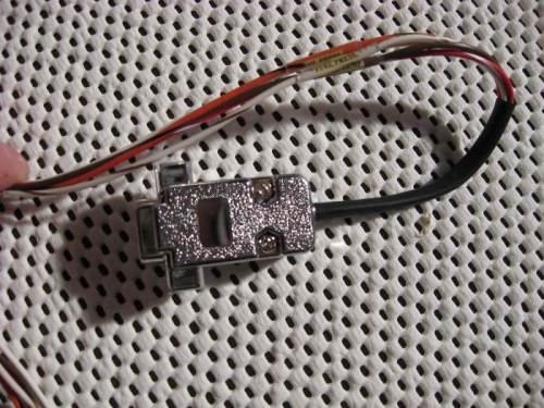

Brief Description:  Primary wiring forward of firewall
Consolidated the main wire bundle that passes through the firewall. Identified those wires that are not required and terminated/insulated them within the loom. Built a DB-9 male/female connector from the EIS-4000 (Engine monitor) to connect the signals for the Fuel Pressure, Oil Pressure, Oil Temp, PSRU Temp and Coolant Temp. Labeled the wires.

DB-9 connector for EIS for monitor signals
