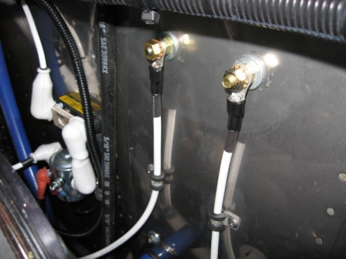

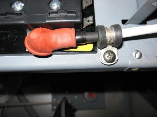

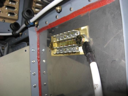

Brief Description:  Primary wiring forward of firewall
Added strain relief to the numerous cables between the panel and the Aproach FastStach Hub. Drilled through the firewall and mounted the ground block with two 5/16 inch bolts. Ran a #6 AWG ground wire from the batteries forward and attached to the block. Drilled a couple of small holes below for clamps for strain relief on the firewall side. Fabrictated two #6 AWG ground straps and secured to each side of the engine block. Ran and attached the #6 AWG wire for the Primary Power bus.
Ground buss with Battery Minus cable
Firewall side with Engine ground straps
Primary Buss power cable
