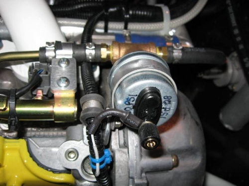

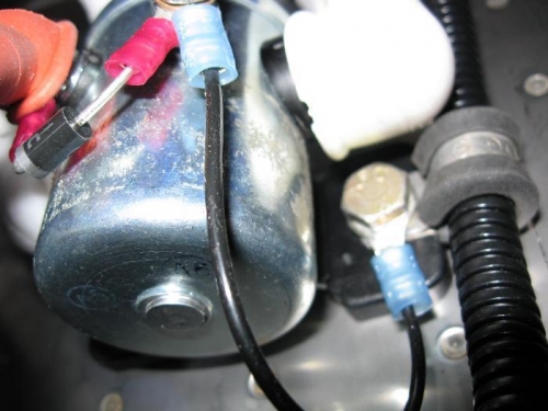

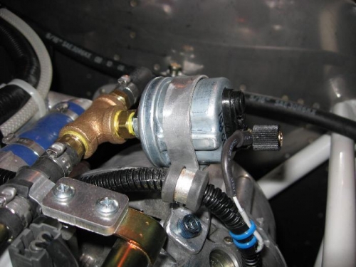

Found that a #22 clamp minus the rubber insulation became a very good grounding strap/clamp for the Fuel Pressure sensor. Fabricated a small mount out of .064 3/4" angle. Ran the wires for the Fuel Pressure sensor and the two wires for the Oil temp and Oil Pressure sensor. Installed the wire for the Fuel Pressure sensor. Left the other two hanging until I can get some more high-temp 1/4 split loom. Pulled back the blue ALT wire and re-did the end to include a 20AWG wire for later connection. Ran these two wires in a loom down to the contactor for the Alternator. Finished the wiring for this end of the device.
Bracket using #22 clamp minus rubber
Another look
Another look
Alternator contactor with ground strap
