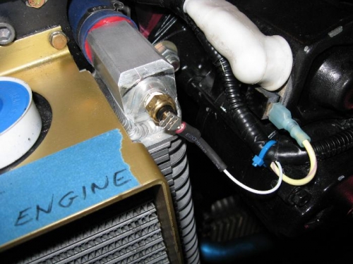

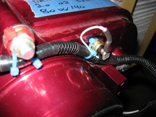

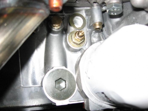

Brief Description:  Primary wiring forward of firewall
Loosened the large 3/4" split loom conduit on the right-top side in order to add 4 x 20AWG wires to run forward. 1 each for the Coolant temp and PSRU temp, and 2 planned for the prop sensor. Strung the wires through the loom and tee-ed off a length of 1/4" split loom for the wires forward. Installed the sensors and crimped then heat-shrinked the connectors for each sensor. Afterwards, installed the VDO 150 PSI Oil pressure sender and the Oil Temp sender. Will run the wires for these later after I order more high-temp 1/4" split loom.
Water temp sender
Water temp sender
PSRU temp sender
PSRU temp sender
Oil temp sender
Oil temp sender
