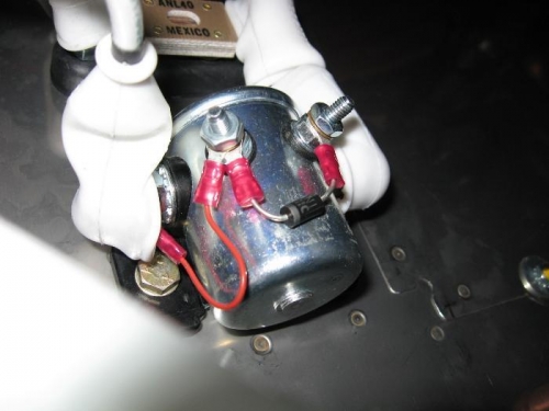

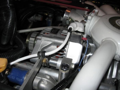

Brief Description: Primary wiring forward of firewall
Using Bob Nuckholls' Interim Z-24 OV protection architecture, I wired from the Alternator B lead to one side of the S701-1 Alternator OV Disconnect contactor. It took a while to fabricate the #6 AWG wire because I made the flag connectors from 3/4 copper pipe. Next, fabricated a brass strap with a 90 degree twist from the ANL series Limiter to the other post of the S701-1.
