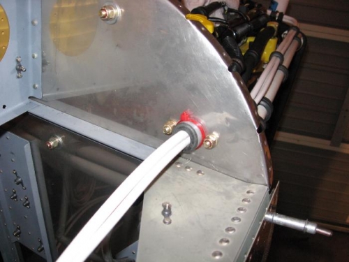

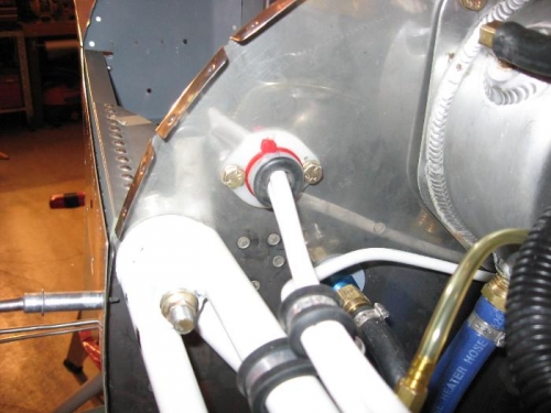

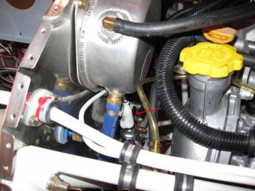

Brief Description:  Primary wiring forward of firewall
Drilled a 1" hole in the firewall for a pass-thru for the primary wiring. Secured the clamp with grommets around the 4AWG and 6AWG cables. Ran the 6AWG cable to the ANL from the starter, and crimped then soldered the connector on the cable end. Secured the cables.
Firewall pass-thru for primary power wiring (firewall side)
Firewall pass-thru for primary power wiring (cabin side)
Cable end at ANL from starter
