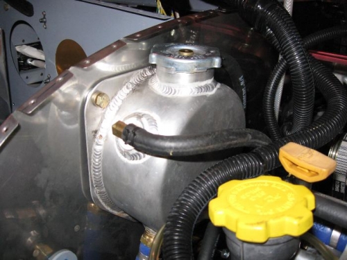

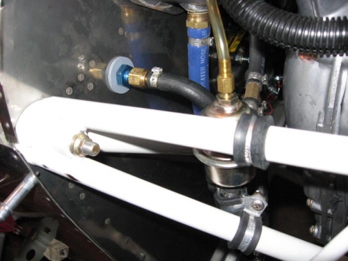

In order to locate where the primary power wires can pass through the firewall it was first necessary to mount both the fuel pressure regulator and the coolant resevoir in order to avoid conflict. After some minor hose length adjustment, the Fuel Pressure regulator was mounted to the engine mount tubes with Adel clamps. Next, three 1/4" holes were drilled through the firewall for the coolant resevoir. Now it's a simple matter to locate where the primary power wires will pass through the firewall.
Fuel pressure regulator mounted
Coolant resevoir mounted to firewall
