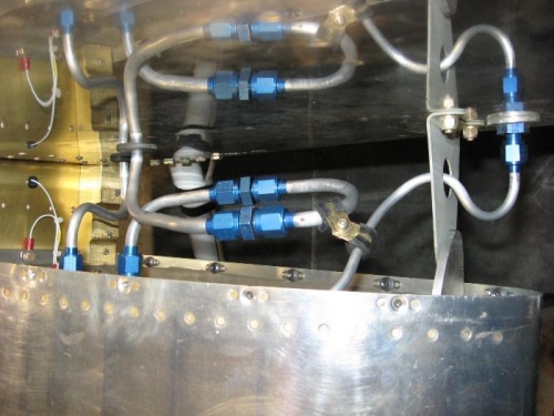

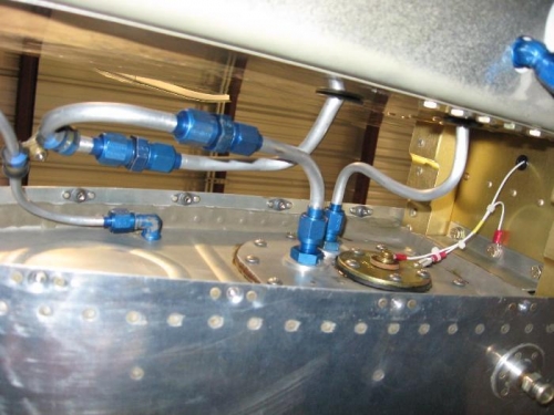

Brief Description:  Wing root hard lines
Bent the tubing and installed the hard (aluminum) lines for the fuel feed, fuel return and fuel vent for the right wing. Installed Adel clamps between the vent and feed to provide stability. The tank attachment still needs to be completed.
A view from above of the return, feed and vent from left to right.
Another view from below
