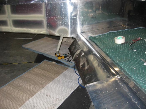

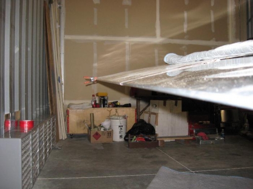

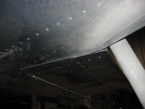

Brief Description:  Flaps installed and rigged
Quite a lot of time spent installing the flaps and getting the rigging set. The holes for the push rods are odd-shaped to allow for the full travel up and down. The flaps just "kiss" the bottom of the fuselage in the full up position, and are in perfect alignment with the ailerons in the neutral position while full up. Very pleased with how the flaps turned out.
Right flap in the down position
Right flap in the up position just kissing the bottom of the fuselage
A view of the left flap fully up, and in line with the aileron and wing tip
