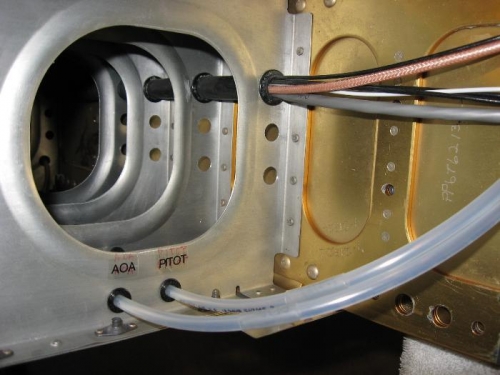

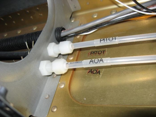

Worked on connecting the Pitot and AOA lines. On the fuselage, pulled the connections for the wing root (Pitot and AOA) lines into the cabin rather than at the outer skin (no room to make the connections at the outer skin).

Pitot and AOA (and wires) coming through wing root
Pitot and AOA connections in fuselage moved inside by one rib
