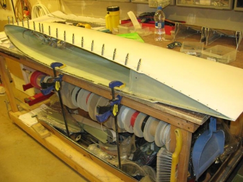

Drilled and counter-sunk the holes for half of the nutplates. Lots of nut-plates!! Drilled and dimpled the wing where the tip attaches. Riveted the tip support rib in place. Hopefully can finish up this tip tomorrow.
1/2 the nut-plates installed with the .032 backing strip

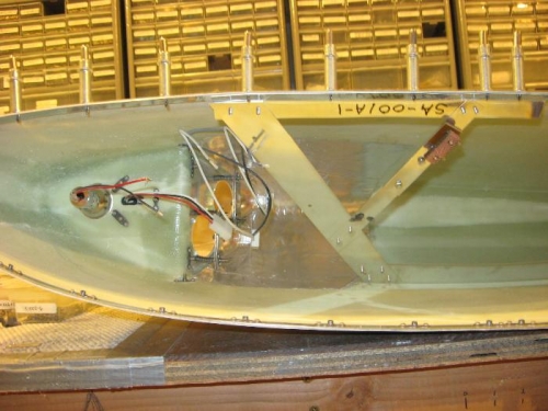

Another view.  (the com antenna will get some glass support later)
