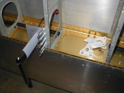

A long day working on various tasks with the wings. First, I secured the conduit with tie-wraps on the ends. Then, in the left wing root, I drilled new holes for the AOA and Pitot lines so they came out in a spot where they could run straight though the fuselage when mating the wings. After the fourth wing-walk rib, the holes in the next outer rib moved closer to the main spar to transition the lines back to the standard holes. The rest of the day was spent working on the mount structure for the AOA/Pitot tube mount. Hopefull I'll have the chance to finalize this tomorrow and start working on bottom skins.
Conduit meets in this bay where there will be an access cover.
AOA/Pitot tube mounting
