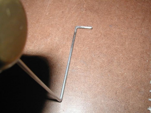

After some thought I decided it should not be too difficult to break out the Oxy Acetelene tanks and weld a section of wire back on to the float wire. I used a small tip and a soft flame to work with the small gauge wire. The weld turned out just fine and is perfectly servicable. Moving on now.
Welded 3/4 inch section onto float wire

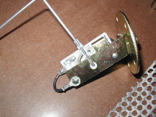

Wire installed correctly into and through the sending unit
