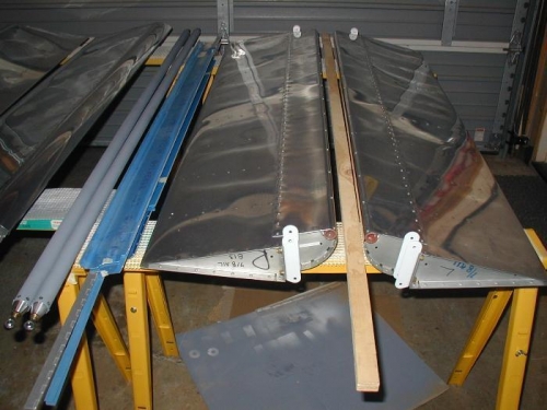

Started the day by finishing the aileron linkages and setting them to the correct length. Next, I spent a couple of hours installing the aileron mounts to each aileron. Afterwards, the remainder of the (long) day was spent working with the F-713x and F-714x parts that make up the aileron mounts on the wing spars. A lot of time was spent cleaning the edges of these parts up to have them look nice. These will be visible each and every pre-flight, and I want to be happy looking at them. Whew, they're now cleaned up and ready for priming and riveting. That will be tomorrow.
Mounts on each aileron (and the finished tubes on the left)
