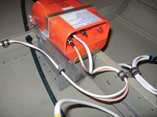

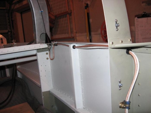

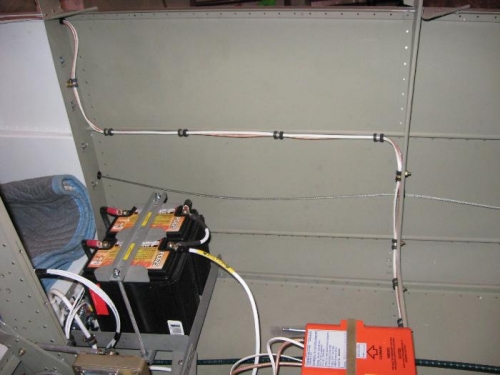

Brief Description:  ELT wiring and trimtab cable
Fashioned and ran the cables for the ELT. I should have enough play in the cables to allow getting the bucking bar in place when riveting the skins. Mike S. stopped by and we worked out the re-routing for the trimtab cable. What a headache that was! For some reason the cable just would not push through the conduit under the seat on the left side, but it would push through on the right. Go figure. As long as the cable reaches, it will work out better to have the conduit on the left side reserved for running the left/right wing strobe wires all by themselves.
Coaxial and remote wire installed (Note the trimtab cable passing thru)

Path the ELT wiring takes forward and up the right side
The white remote wire continues forward to the remote switch in the panel
