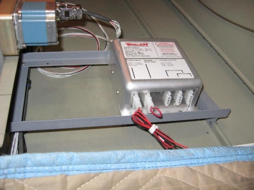

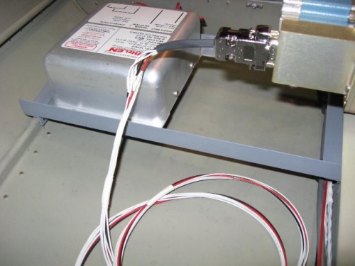

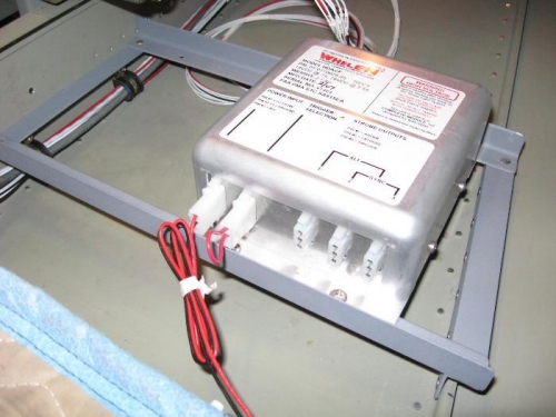

Brief Description: Whelen Strobe power supply mount
Fabricated a mount for the Whelen Strobe power pack. I have been spending quite a lot of time sorting out how to mount this. In the end, I used the same basic structure that I used with the battery mounts. Very sturdy and reasonbly light weight given the support required for the power pack. The power pack is mounted with 4 x #8 screws to nutplates on the bottom side of the 3/4 angle. Getting closer to closing up the aft fuselage...
