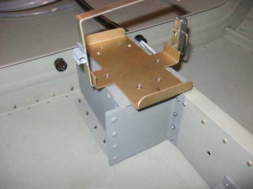

Brief Description:  ELT Mount
The ELT needs to be mounted to a rigid structure, preferrably in the tail. Decided to build up a support at the F-707 bulkhead. I still have yet to rivet to the bottom skin waiting on snagging some help for that. Very happy with how sturdy the mount is while not to bulky of a structure. Next will be to mount the antenna and run the coax and remote wiring.
Base plate for ELT secure with 6 x #6 nutplates

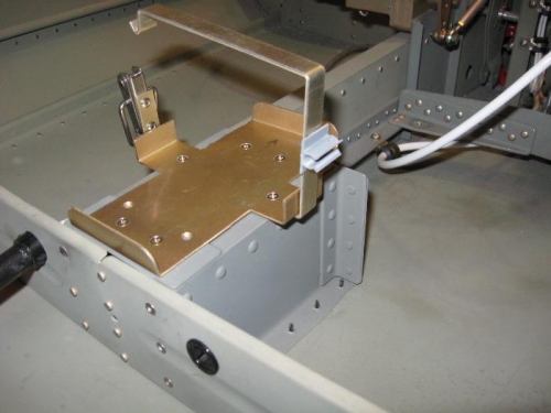

View from rear
View from rear

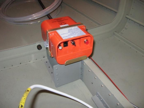

ELT mounted.
ELT mounted.
