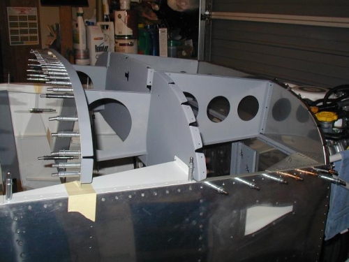

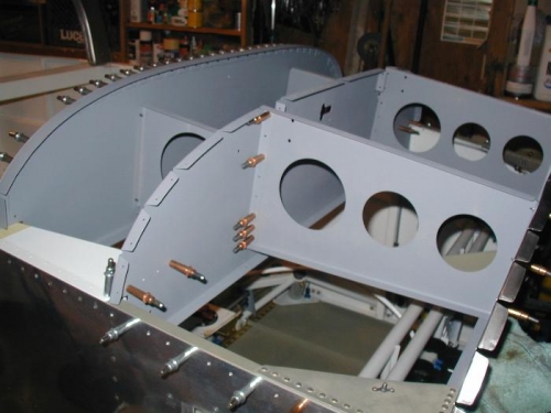

Brief Description:  Debur and prep upper fuselage parts
Continued with the prep work on the upper fuselage along with priming the sub-structure and the back side of the panel. Match-drilled the F-703B and F-703C to the F-703 (Panel). Began initial assembly in order to line things up for match drilling various parts to the structure.
Some of the many parts deburred and primed

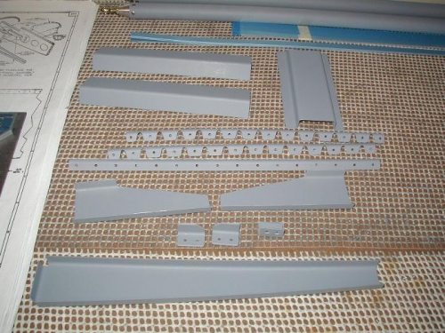

Some of the larger parts making up the upper fuse sub-structure
