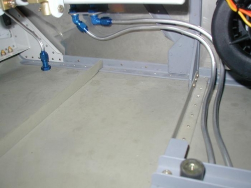

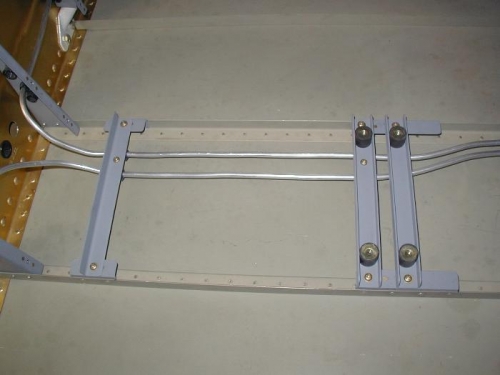

Ran the left and right brake lines through the center cabin and out to the top of each main gear leg. Used Adel clamps under the Fuel Pump mounts to suspend and support the lines. Also made four 1/8" washers as stand-offs between the heater motor housing and the firewall. Then moved on to attaching the fittings for the various connections to the Fuel Switch.
Brake Line routing from left side under pedals
Brake Line routing through center cabin

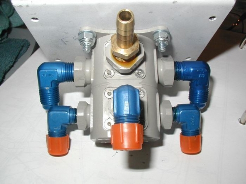

Fuel Switch fittings installed
