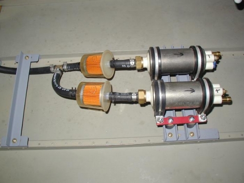

Brief Description:  Fuel Pumps
Drilled the fuel pump mount brackets and installed nut plates. Primed the mounting hardware, then riveted the angle brackets to the airframe. The pump mount cross-brackets as well as the vibration mounts are installed with pan-head screws for easy maintenance access. The aft cross bracket will be a location to secure hard lines and wire conduits.
Fuel pumps mounted
Fuel pumps mounted
