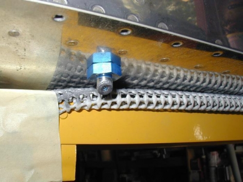

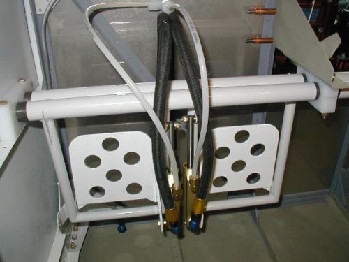

The JB Weld on the screen setup just fine. After some trimming and shaping on the scotch brite wheel, the parts were ready for installation. Next came bending the Fuel Vent Line tubing on the right side followed by the left. I then mounted the brake resevoir on the pilot side of the firewall as this airplane will only have left side brakes (after 5 years of flying a Mooney with only left side brakes, I'm very comfortable with this arrangement and it saves a bit of work and weight). Afterwards, I drilled the left and right master cylinders to each pedal, and fitted the lines. Next will be to run the brake lines to where they will exit the cabin at the top of each main gear leg.
Right side Fuel Vent line with screen

Brake pedals and plumbing
