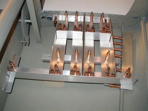

Brief Description:  Battery mounting
Modified the mounts for the battery tray. Finished drilling the mounting brackets to the fuselage. Next will be to complete the fabrication of the hold-down strap followed by debur, countersink and prime.
Mount on the left is 3/4 x 3/4  x 1/8 with 8 staggered holes
Another view
Another view
