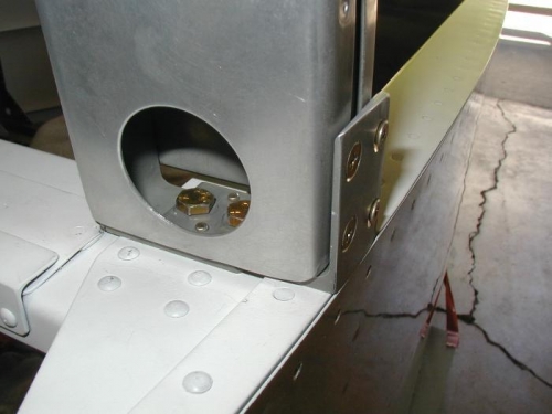

Brief Description:  Cabin Frame
Trimmed the portion of the F-631C protruding outside the contour of the fuselage. Once this was completed, bolted the parts to the F-705 and used the F-774 skin to locate the forward screw holes that join the skin to the F-631C bracket. Drilled/Counter-sunk the remaining holes in the F-631C brackets, both sides. Dimpled the F-774 skin.
F-631C drilled, counter-sunk
