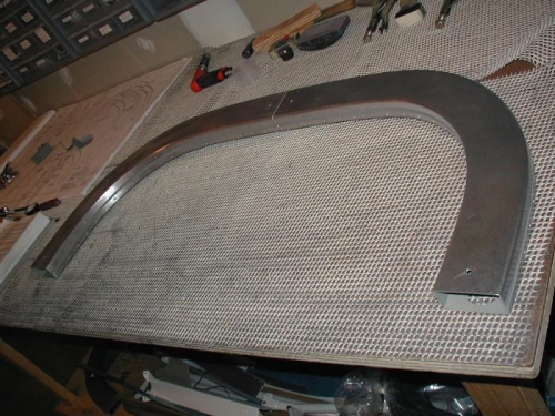

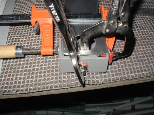

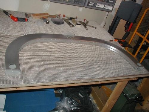

Riveted the Cabin Frame together, including the F-732D angle on the rear half. Whew! Also clamped the F-631 C&D angles to the outside and inside of the frame on both sides. This in order to drill for the keeper rivet which will hold these parts together during installation of the frame on the fuselage.
View of the aft side
View of the forward side
Are there enough clamps here?
