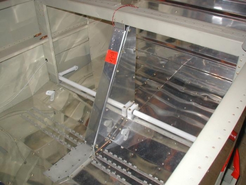

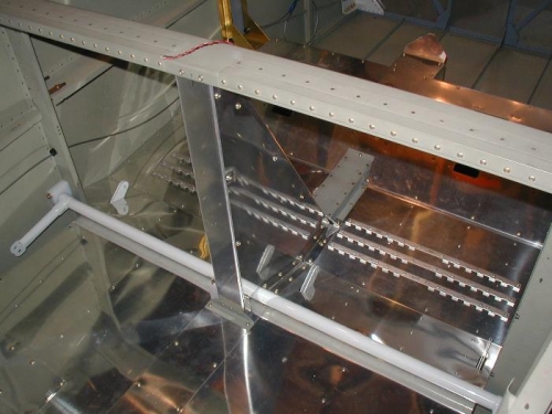

Installed the F-785A backrest brace and fitted the F-760 Flap Actuator Covers. Enlarged the hole around the bolt head attaching the flap motor. Drilled and installed the nutplates in the F-785A backrest brace.
Completed Flap Assembly - view from in front
A view from aft
Another shot from aft
