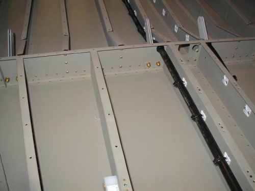

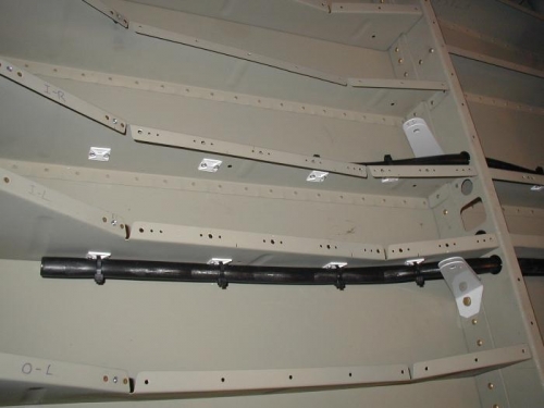

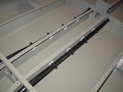

Brief Description:  Conduit in center fuselage
Decision was made to install a pair of conduits permenantly under the seat and baggage floors. This should be sufficient to route the additional cables required for the two rear-mounted batteries. The conduit is with tie wraps. The tie wrap mounts are riveted with pull-rivets, two per tie-wrap mount. The tie wrap mounts are positioned on both sides of the ribs and share the rivets. Wiring in the center tunnel can be tie wrapped alone, or within a conduit with a split down the center. The flooring can now be completed.
