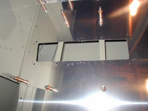

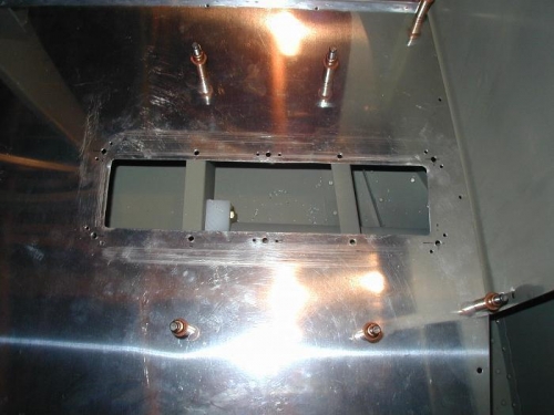

Mike S. came over and we decided to work on access panel cut-out locations. I've wanted to make sure that I have a removable panel for inspection in all three bays under the baggage floor on each side. This location provides the means to inspect the nuts on the step kit mounts as well as the nuts on the seat belt anchors looking forward. In the picture of the left side, you can see the step kit mounting block and one of the bolt heads. Making the covers and installing the nutplates is next. Then it's on too completing the right side step kit.
Right side access panel
Left side access panel
