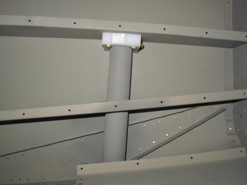

Brief Description:  Step kit, left side
Completed the installation of the left side WD-657 Step kit. Prior to installing, I cleaned and primed the inside of the tube that extends into the baggage compartment and made sure the primer was completely dry. Cleaned and primed the remaining exposed steel. Used blind MSP-42 rivets because I did not want to un-install the F-750 baggage side panel and these rivets are plenty strong -- this step is not going anywhere. Next will be to install the right side.
Step kit, left side installed (gonna have to pad that!  it's at knee-cap height)
Used MSP-42 blind rivets
Secured to baggage rib
