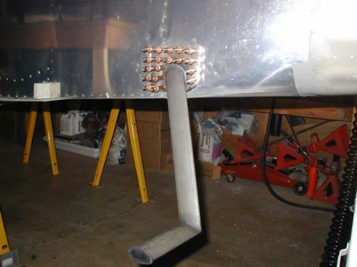

Brief Description:  Step kit, left side
Spent several hours working on the placement and fit of the left side step. Made sure that the forward vertical edge of the mount was parallel to the F-724 vertical rib. Also located the second vertical row of rivets in a position that passed through the F-724 flange and that the rivet holes missed any existing rivets in F-724.
Left side step drilled to skin and F-724
