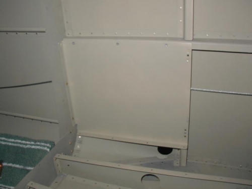

Left side F-750 Aft Baggage panel. Note the rudder cable passing behind.

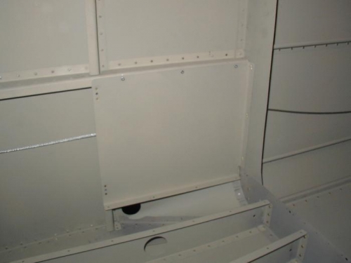

Right side F-750 Aft Baggage panel.

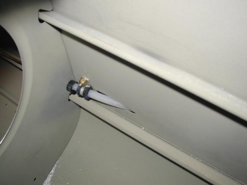

Right side rudder cable passing out through aft fuselage
