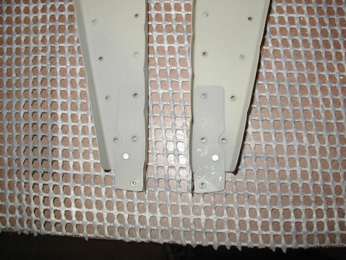

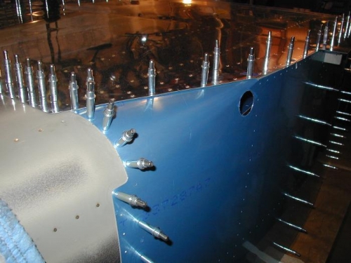

The conical bend in the F-770 side skins where the center fuselage joins with the aft fuselage was formed. This took some time to do. Note: In the pictures below, the F-770 skin is shown nested underneath the bottom skin at the conical bend (as shown in Plan Drawing 28, Detail D). This, I found out later, is NOT correct. The F-770 skin will overlap on the OUTSIDE of the bottom skin. I verified this by inspecting a friends RV-7A Quick-Build fuselage. No problem at this point, as I know this now, and will be certain to assemble this correctly later on. Attached the forward F-623A attach strips to the F-623 corner baggage ribs.
Right side
Right side
Left side
Left side
F-623A riveted to F-623
