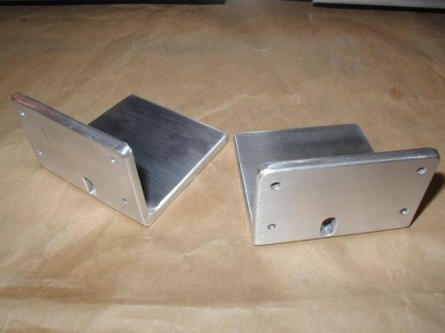

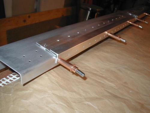

The 3/4 angle was fabricated for both left and right sides. The height is 1/8 inch off the top of the spar. This allows a small horizontal slot which accommodates the flange on the back of each seat. Began work on the left and right side angle supports for the tip-up canopy which provide the latch base for the canopy. The flap bearing blocks were also drilled at this time.
