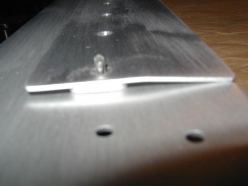

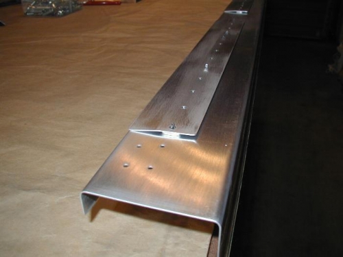

The back of the seats have a flange that rests in an assembly on top of the F-705 bulkhead. A spacer is fabricated (both L and R), along with a plate that requires a 4 degree bend. Behind this a 3/4 angle (shown later) is attached thar provides the stop. It takes quite a bit of time to get things cut, bent, lined-up and match-drilled.
Right side spacer and plate
4 degree bend in plate
